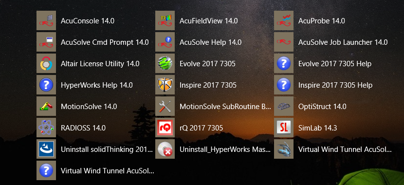

This issue was resolved by reinstalling the machine :)
BUT, still not quite there yet. The interface I see is attached as an image. Is there no way to get the same graphical interface when starting an analysis out of hyperworks (second image)
